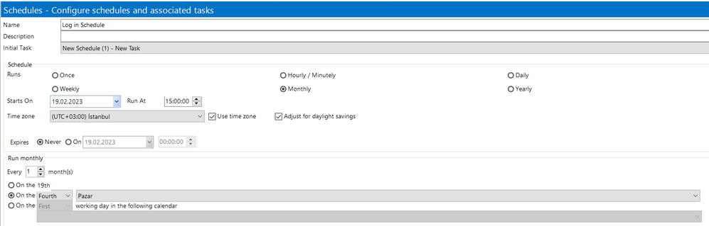

ÖzençGezgin
Hi @Ajithran Balasubramanian ,
  • Install Login Agent
  • Create Login and logout process
  • Than Schedule login and logout process
Logout Schedule:
Select monthly
Starts on time: 01:00:00
Run monthly section you can select On the fourth Sunday
Login Schedule:
Select monthly
Starts on time: 15:00:00

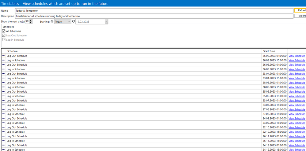

You can see schedules with Timetables
Show the next days section select 999 and press refresh button.
Here is the shedule timetable
