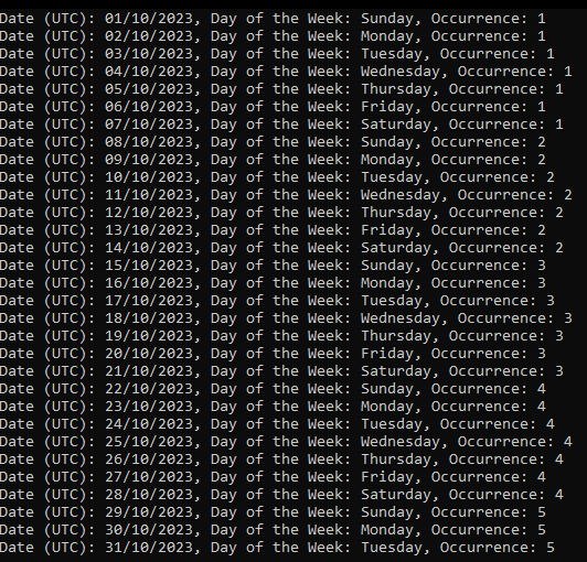

Note that the code run from Visual Studio gives a different result to the code run from the code stage in Blue Prism. I've shared the codes for Visual Studio as well as code stage at the bottom of this thread. Both visual studio code and the code stage were executed/ran from the same machine.

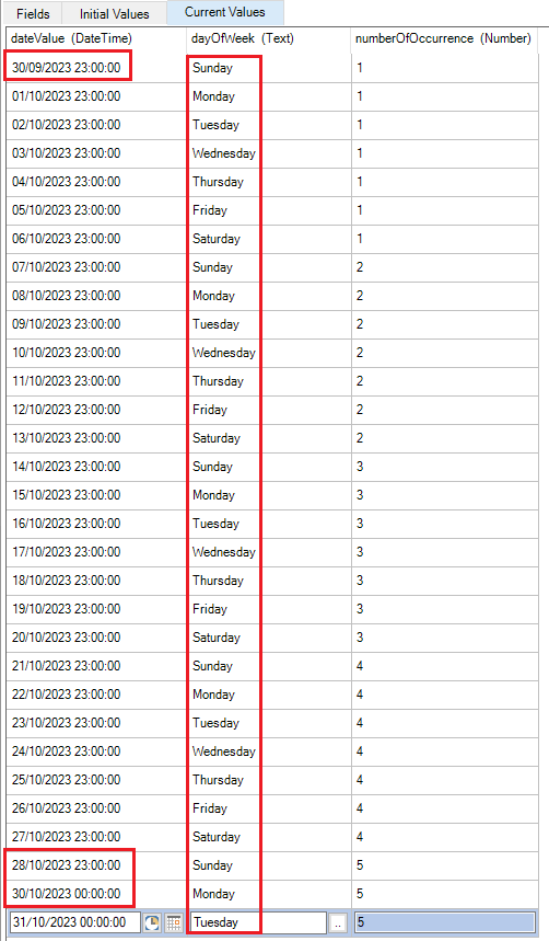

Result from Visual Studio: (date starts from 1st October and ends in 31st October). The day of the week associated with the date is also correct (1st October 2023 is indeed a Sunday, and the first Sunday of the month).
Result of the code stage:
- Date range starts from 30th September (instead of 1st October).
- 29th October is missing
- The day associated with the date is wrong (for instance: 1st October is not a Monday).

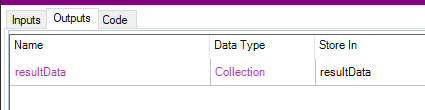

An output named resultData as collection:
Value in the code tab:

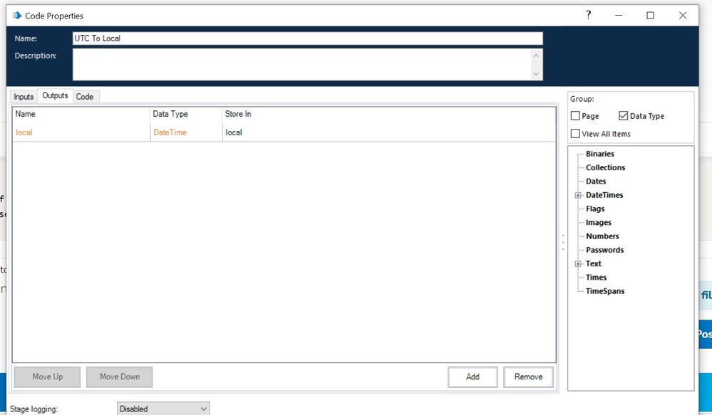

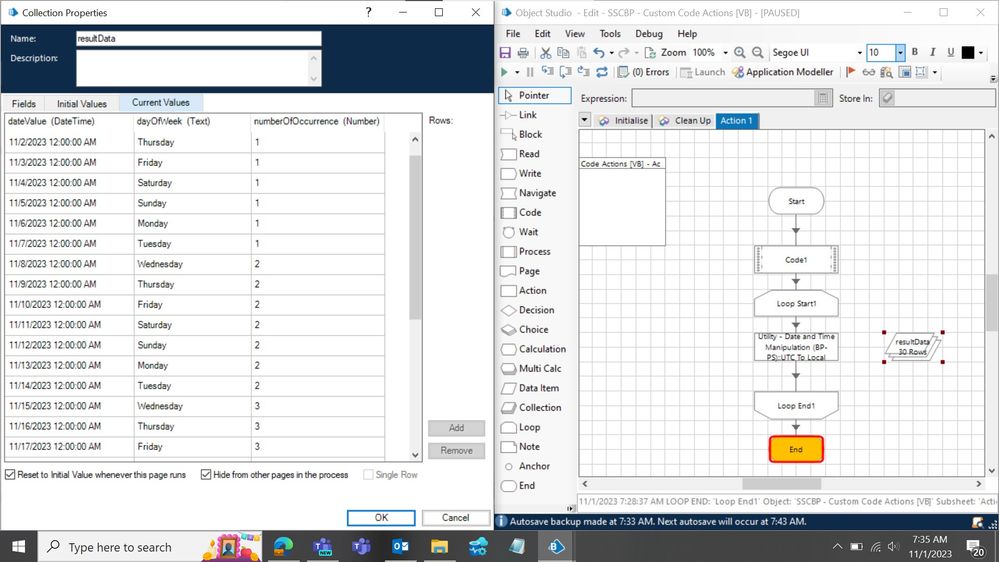

Strange one. I just ran your codes on my BP, 7.1.1 and I got the anticipated result for November. I think Blue Prism uses your local OS time to do DateTime variables. If you convert the UTC back to Local Time, I wonder if that resolves the bug. I don't know enough about your code to hardcode the month of October into the code stage. I have added an action in a loop to convert UTC back to Local, now everything is being set to the top of the hour for every row. I have attached the code for converting UTC back to Local and its input/outputs. You could add it to your existing code or do as you please with it. Let me know if this works.
'Declare and set variables for code use
Dim utcDateTime = DateTime.SpecifyKind(UTC, DateTimeKind.Utc)
Dim tz As TimeZoneInfo
'If given time zone then find a system time zone associated to then convert
If Time_Zone_ID <> "" Then
tz = TimeZoneInfo.FindSystemTimeZoneById(Time_Zone_ID)
local = TimeZoneInfo.ConvertTimeFromUtc(utcDateTime, tz)
'If not then just use local time as UTC
Else
local = utcDateTime.ToLocalTime()
End If
' BP converts local dates back to UTC for its
' internal representation; so we have to convince it that
' this is UTC already so it doesn't convert it further.
local = DateTime.SpecifyKind(local, DateTimeKind.UTC)
