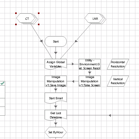

I had a process working on a VM hosted on-prem without a problem, during this process I need to take a screenshot and save it on local drive.
When I moved the process to another VM hosted on GCP the screenshot is no more working (I don't receive any error but the screenshot is saved as a Black picture), the process can continue working without a problem but the screenshot will always be black.
I don't know if there is any setting I can enable.
I am using Image Manipulation V1 from VBO, I tried another Object without a success
Thank you for your help

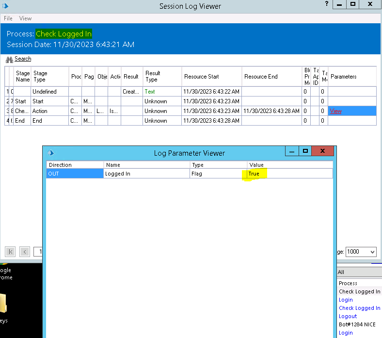

I am using Login Agent to access the Ressource not RDP
Do you have any idea please why I have this problem even if I am using Login Agent ?
I tried Check Logged in Process and it gives me True
Thank you

If the DW is in the 'no desktop' state I mentioned, Check Logged In will still return True. This is why I suggested the Log Off > Log In > Screenshot experiment. But if you have done this, then perhaps the problem is something else. Could there be something wrong in the VBO?
