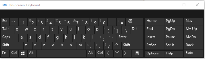

Hi Robert,
It can be related to the keyboard layout and language.
I suggest checking the layout on your PC with the developer's PC keyboard are the same layout and language.
You can also use the keyboard command to see if you press "L" the keyword react or not.
Start menu > Run > osk
