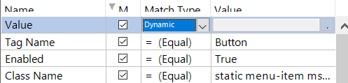

Have you tried setting a dynamic value on the element when you spy it in SAP? For example, if this were a web page and I were looking for a button with a value that could change at run-time, I would set the Value field as dynamic in Application Modeler.
If that doesn't help or doesn't work in your case, then I'd try to find out where exactly the collection is becoming unordered. If you can get the correctly ordered collection from SAP, then somewhere along the way in the comparison you're doing with Excel, it's likely changing the collection such that it loses the original order from SAP.
