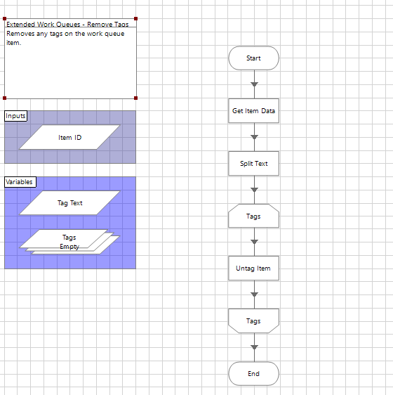

While there's not an action in the Work Queue object to remove all tags, since tags can be modified without locking an item, you can create your own action to handle it. Here's an example of one such action. Split Text points to the action in Utility - Strings and splits on a semi-colon. Get Item Data and Untag Item are both Work Queue actions.
One thing I would point out is if you needed to tag the work queue items with something aside from the "StepX" stuff, then this would potentially cause a problem with that. I'd personally recommend adding some kind of filter that lets you clear specific tags, for example maybe only clear the tag if it starts with "Step".
