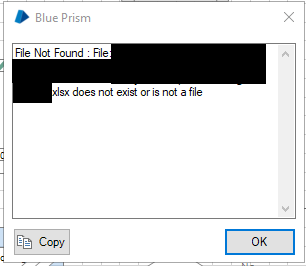

24-09-19 08:57 AM
The error message is a standard message saying that the file does not exist

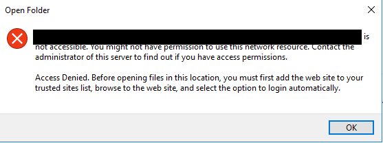

I also get the below message when trying to access the files through file explorer
So I guess that means it is a permissions issue for the VM rather than a BP issue? It's my own profile when logging on to the VMs, and it works on most of them so it's not an issue with my user profile I don't tink

05-11-19 10:14 PM
Looks like you have issues in authenticating the share point site. You can access share point via UNC which will navigate you to the folders in share point .
Let me know if you have any followups.
