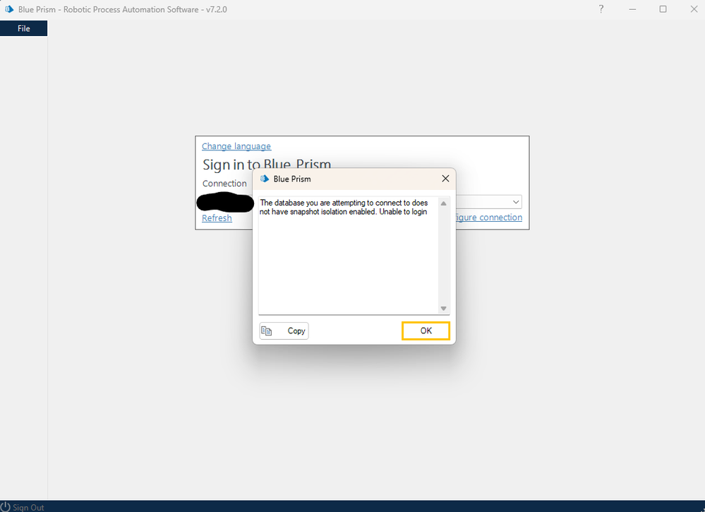

We did try changing the settings as below and got error during login therefore we had to revert the settings.
Is Read Committed Snapshot On" to TRUE and Allow_Snapshot_Isolation to FALSE

make sure nothing is running in blueprism , schedulers , bots etc , and you have enable both and then you can try
