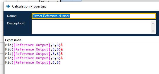

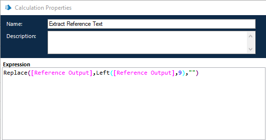

I want to split numbers and text and store them in different columns; reference number and reference text.
1/ I have a reference text box which has multiple lines; for example
In "Pet Category" Reference, we have:
[8899] cat - cat food
[9988] dog - dog food
[7788] pet - pet food
[9977] cow - cow milk
My BP code for splitting numbers and text is shown below. However, it only works for [8899] cat - cat food, but not others [the other references are not split - still in original form) Note: Since the code, Mid([Reference Output],3,6) is for extracting numbers and Replace([Reference Output],Left([Reference Output],9),"") is for extracting text. The result will be [8899] and cat - cat food [which are separate for reference number and reference text columns].

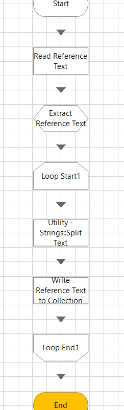

Maybe the first step is to split the text into a collection of lines (Utility - Strings). Then loop through the collection and split the line into number & text.

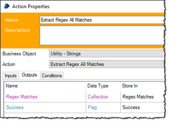

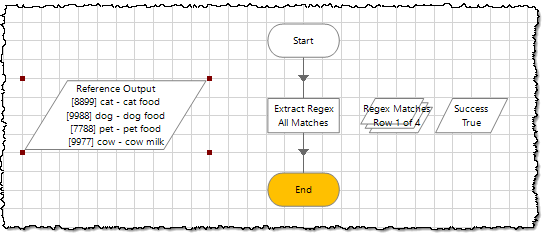

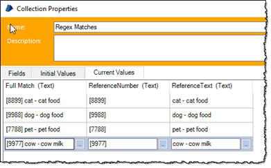

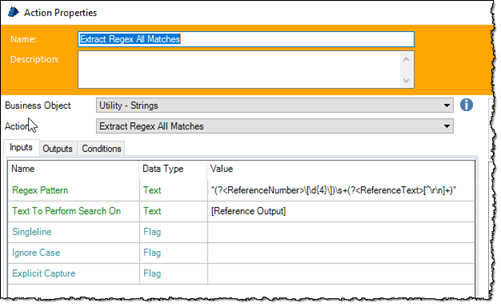

You can use the action "Extract Regex All Matches" from Blue Prism's Utility - Strings VBO (Blue Prism Digital Exchange - Utility Strings) to extract that information into a collection.
(?<ReferenceNumber>\[\d{4}\])\s+(?<ReferenceText>[^\r\n]+)
What you will end up with is a collection of data that of all matches no matter how many lines your original text has:

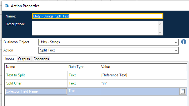

If you are just looking to split text by lines into a collection, as @John Carter pointed out, I would use the "Split Lines" action in Blue Prism's "Utility - Strings". Regex would be overkill in that situation.

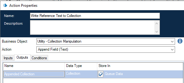

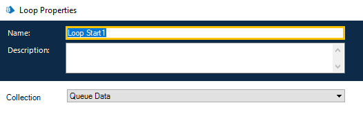

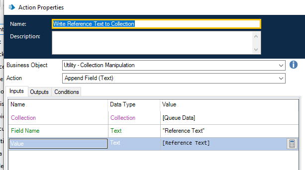

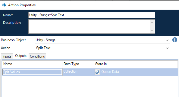

29-09-23 10:26 PM
Hi can you please have a look at my steps, I follow the steps, add loop, add split text. but it still doesn't work correctly
and result look like this: [8899] cat - cat food[9988] dog - dog food
