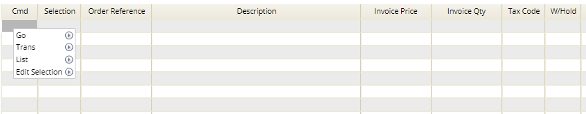

Very new to RPA (and Blue Prism) and have been tasked with developing an object to input data into a Dynamic HTML/Javascript table. A screengrab of this table is below:
Now, this actually highlights the problem quite well - that Description cell (highlighted) is initially an input field when navigating to the page, but as soon as anything is clicked off, the cell ends up like this.
After pulling my hair out about this, I discovered a mini workaround which can be achieved by sending a Global Mouse Click (Right), which leads to this (should say, this is through highlighting the cell in Cmd Row 1 as UIA):
25603.pngNavigating manually to List enables me to select another item 'Form' which enables me to enter each row in a regular form, which is much easier to spy.
However, when trying to replicate this list in Blue Prism, I'm able to successfully bring this menu up, but navigating through this is again making the menu disappear.
So far, I've tried using Global Send keys "{Down}" "{Down}" etc., but this appears to 'spook' the menu and it disappears (this does work when doing it manually).

do you know if the classes/Ids of the table elements are static? You could Spy the HTML elements like this and just increase the match index as needed (pass it as a dynamic attribute and use a count to increase it as the rows increment).
Try interacting with the table with the Browser Developer tools enabled and see how the HTML behaves.

the two HTML elements you want to look at are class (in this case "dojoxGrid e5h5Grid") and id ("0_0"). If you only need to write into certain columns, I would try to make a dynamic element in the BP application modeller based on unique attributes of a column and then use the Match Index as the row index.
The class name from above does not look totally dynamic (au-contraire to what happens in Salesforce, for instance), so perhaps they will be unique for every column. Using the dev tools of the browser and the inspect option (where you can hover and click with the mouse on the elements and it will point you to the corresponding code snippets) you could assess if this is a possibility or not.
I would highly advise against UIA when it comes to editing fields as bulk, because it is incredibly slow and tedious.
