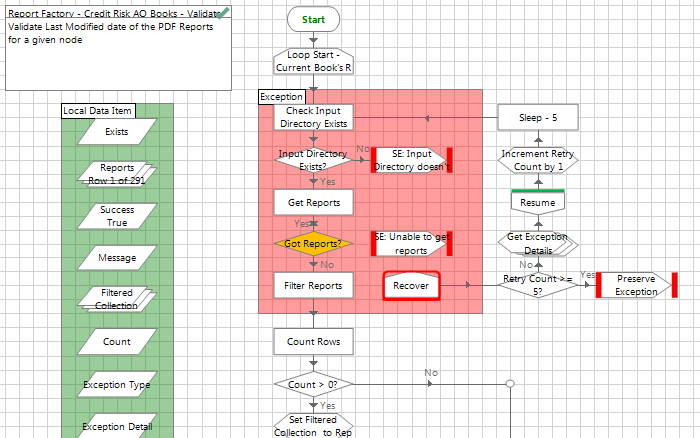

Hello everyone,
I am facing an issue in my automation. My Automation will pick PDF from a particular shared drive and combine certain number of PDFs to stitch a book.
Each book approximately have 10 PDFS. Around 750 books has to be stitched in a span of 4 days.
Automation is running successfully for certain period and is failing while using Get Reports action after approximately 50-60 books are stitched.
But it's always failing at Get Reports action only. Below is the error log.
Here BOT has retried 5 time before throwing exception.
The Get Reports action retrieves report from the same folder for every book. It has completed successfully for 50-60 books after then it's failing.
The folder has around 250 PDFs
Can anyone help me?
Get Reports | Action | ERROR: Internal : Unexpected error Invalid value '2020-04-15 18:54:17Z' for a new datetime |
Get Reports | Action | ERROR: Internal : Unexpected error Exception of type 'System.OutOfMemoryException' was thrown. |
Get Reports | Action | ERROR: Internal : Unexpected error Invalid value '2020-04-03 01:26:06Z' for a new datetime |
Get Reports | Action | ERROR: Internal : Unexpected error Invalid value '2020-04-16 13:40:11Z' for a new datetime |
Get Reports | Action | ERROR: Internal : Unexpected error Invalid value '2020-04-15 18:59:37Z' for a new datetime |
Preserve Exception | Exception | ERROR: Internal : Unexpected error Invalid value '2020-04-15 18:59:37Z' for a new datetime |
Can anyone help me?

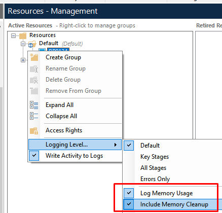

17-04-20 09:47 AM
Enable the memory logging on the resource and see if you can find where/how the memory is being consumed.
