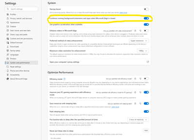

I faced similar issue once - Although we only use Chrome. but when edge is also installed in the same machine, it talks to BP in the background - resulting in failure of chrome
this is what worked for us - Set settings in Edge to not run in the background. May be kill edge and then start chrome. in short ensure Edge is not running in the background before starting chrome and vice versa.
Try turning off uncessary things in above picture and see if this helps
