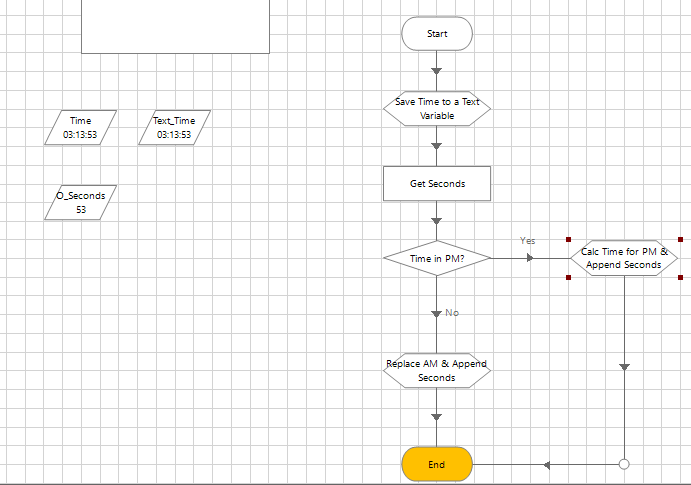

As far as I understand from the conversation I see the issue is with time data item, I don't see anything to stop the conversion from "HH:mm:ss" to "hh:mm:ss" hence converted the time to text equivalent with few steps.  Attaching the screenshot of the flow for converting time to text.
Save Time to a Text Variable -- This calc will store Time to a text type that has AM/PM
Get Seconds -- Gives the number of seconds in the Time data item. I_Time is the input parameter for action and the code stage, O_Seconds is the output parameter for action and code stage
Following is a code that gives you output as seconds

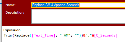

 Calculation stage for AM timing

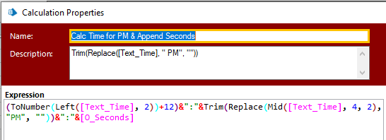

Calculation of PM  time
Now if we use text it has no conversion, hope this helps.
