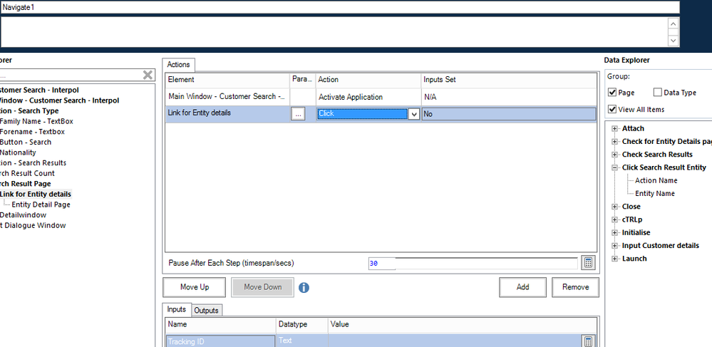

In Browser mode I need to click on a person's name (it's a link that will navigate to some page).
The problem I am facing is - I have created a flow in Objects for clicking on the name. But when I do that it does not click on the name. I have tried various options. Please help. Attaching screenshot below for the navigate actions -

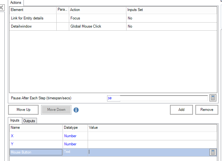

​Hi Michael,
I am unable to spy on other modes. It allows only browser mode for spying. This element is seen on a window opened on chrome. I tried using what you told in navigate. Please see screenprint below. But it gives error. Looks like I am missing something. Please see screenshot below. What should I put in inputs? Is input required for mouse button ?
Swati Agrawal
Hi Swati
Sorry I should have said in the inputs for the global mouse click you should write "LEFT" in the mouse button field. This is left mouse click and should work for you, I also should have said select Global mouse click center since its a button but Global mouse click or Global mouse click center should work the same.

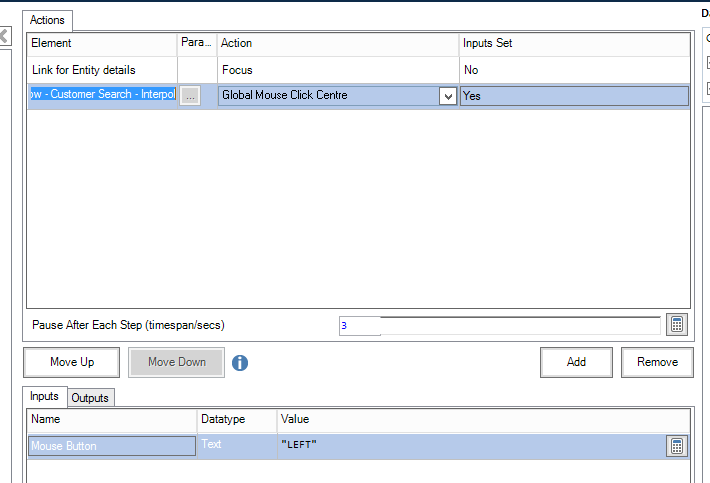

​OK. So, is the below screenshot correct? However, its still not clicking on the link 😞
Did I do anything wrong?
Swati Agrawal
Hi
This looks right so should work. Can you share a screenshot of the application you are using and where the button is? what you could try which ive found sometimes resolves these issues is place the focus in one navigate and the global mouse click centre in a separate navigate. I've found with websites sometimes having them in the same navigate can prevent it working as well.
