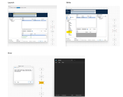

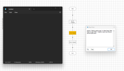

I'm currently taking the Blue Prism Foundation Training. In the Section 5, where I need to open and close a notepad, it seems like it doesn't take the action of writing the notes in the Notepad. I kept on getting below error.
"Internal : Failed to perform step 1 in Write Stage 'Write Note' on page 'Write' - Unable to match any windows with the query terms"
I am attaching the screenshot as well for the Launch and Write. Basically, I replicated what's in the training module.
Appreciate the help.

I hope you are using Notepad object that you created your own.
Can you please check whether the Text Area that you spied still highlighting? If it is not highlighting, spy it again. It would be great, If you can share screenshots of attributes of spied element and the implementation of write action in the Notepad object.

Blue Prism not able to identify your Notepad's Text Area. You will get more idea about this in coming sections of Foundation training and you can correct it yourself. In between, can you please change your black color Notepad to default white color Notepad and try once more. I am not sure, whether it will work, but you can try.

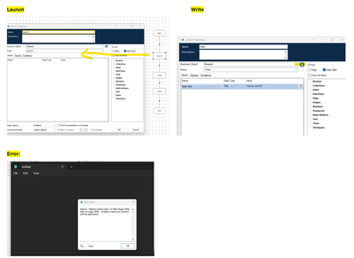

I am replicating the activity cited in Section 5 - Business Objects and Action Stages but, don't get the same result. Currently, stuck in Write. A notepad will open but, an error message pops and won't push through with writing the "Hello World" text. As I am still new to Blue Prism, what do you mean by "Spying" ?

In BP, "spying" refers to the process of identifying and defining the elements of an application that your automation needs to interact with.
"Unable to match any windows with the query terms" in Blue Prism, it means that the spying mechanism could not find any elements or windows in the application that match the criteria you specified.

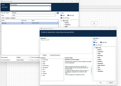

I noticed that in the Writer Properties, Note in the Write action is in grayscale. I think I am missing an action item like Activate the text area of the Notepad.
Appreciate the assistance and let me know if you further need screenshot.
