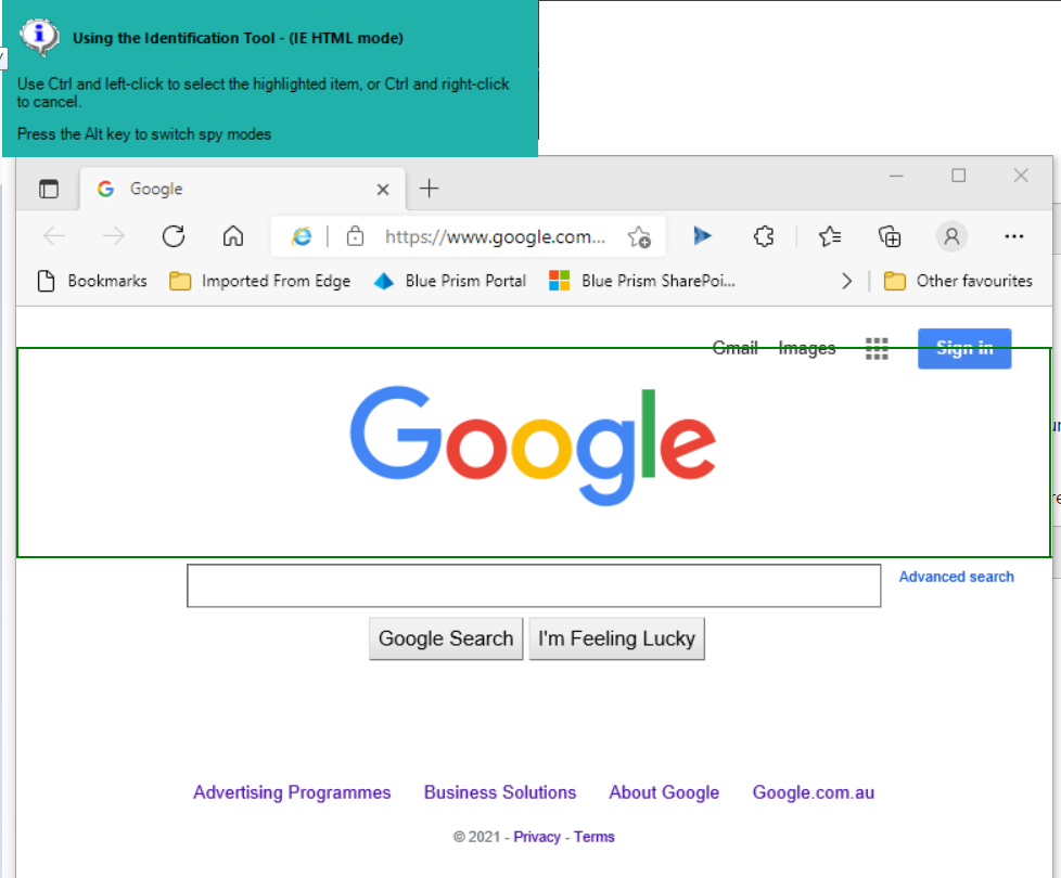

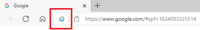

  1. Make sure when you have the Edge browser launched, IE mode is being applied to the website in question. You should see an IE icon next to the address bar. If you do not see it, you must validate your configuration. If things do not look the same, you should seek IT assistance. See below for an example of me launching Google.com in IE mode for Edge:36301.png

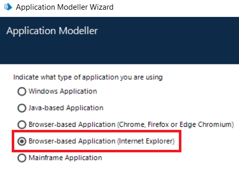

  2. You must configure Blue Prism using Internet Explorer mode, instead of the modern browser mode. 36302.png
