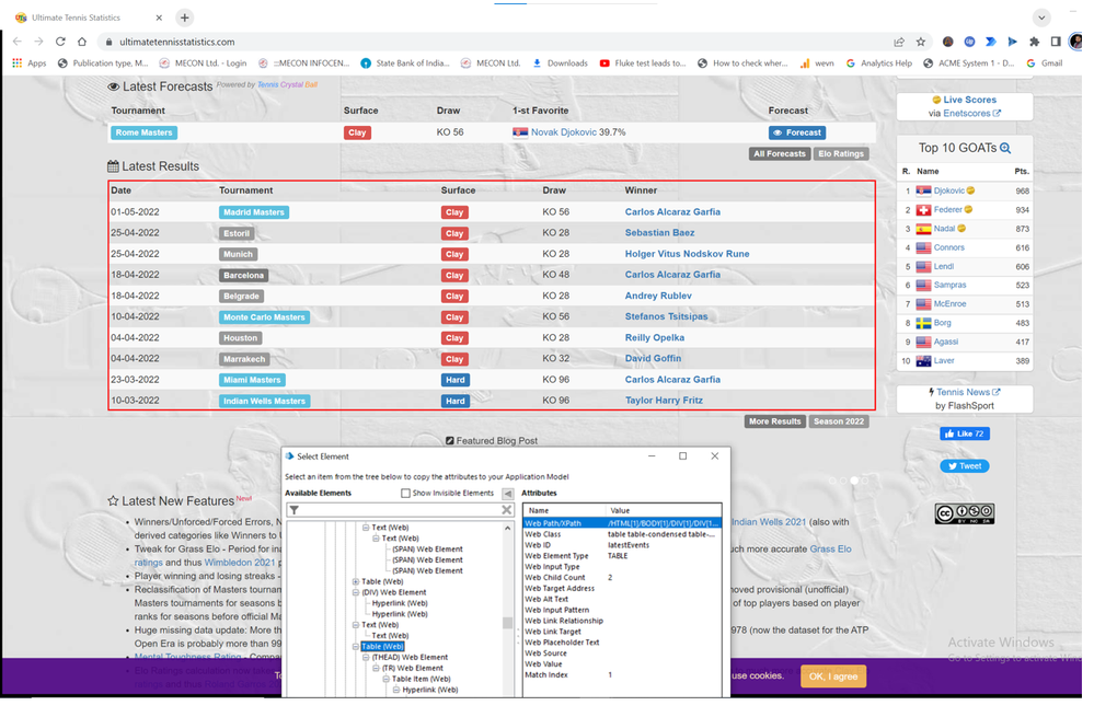

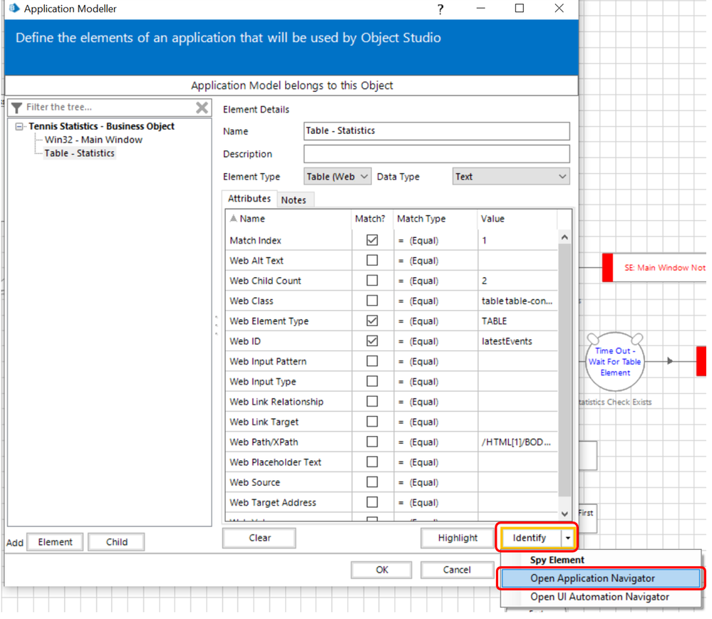

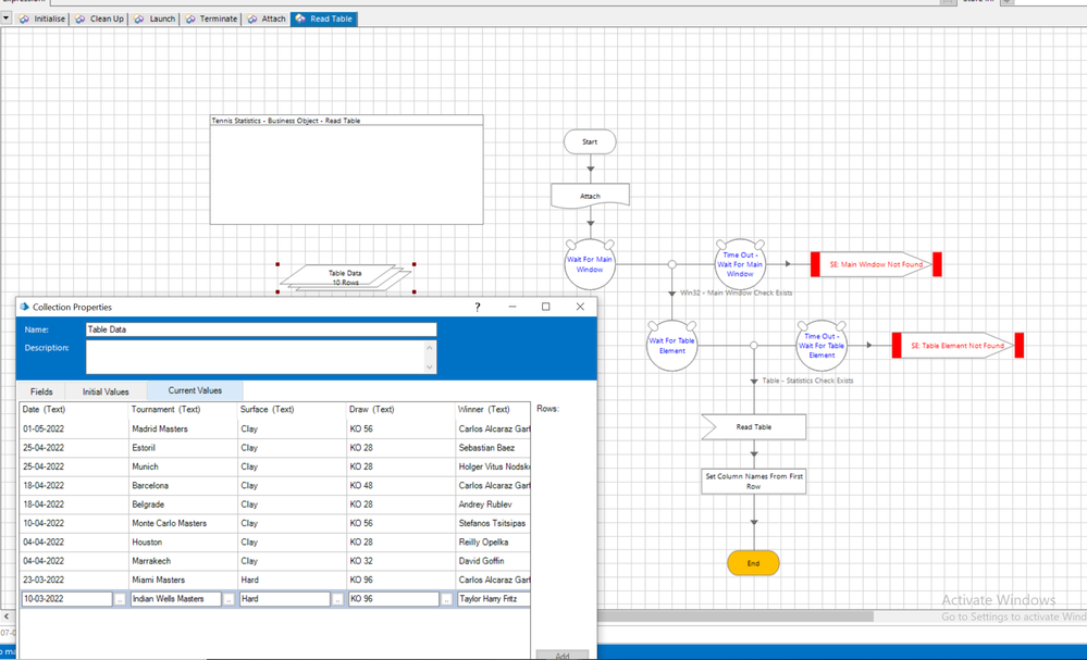

You will able to spy the table but not using the normal spying mode but you can try using the Application Navigator option as the table element is not easily spied using normal approach. You need to select the below shown option:
Now in the application navigator, you need to search for the table element once it loads up. As you can see, I was able to get the below spied element:

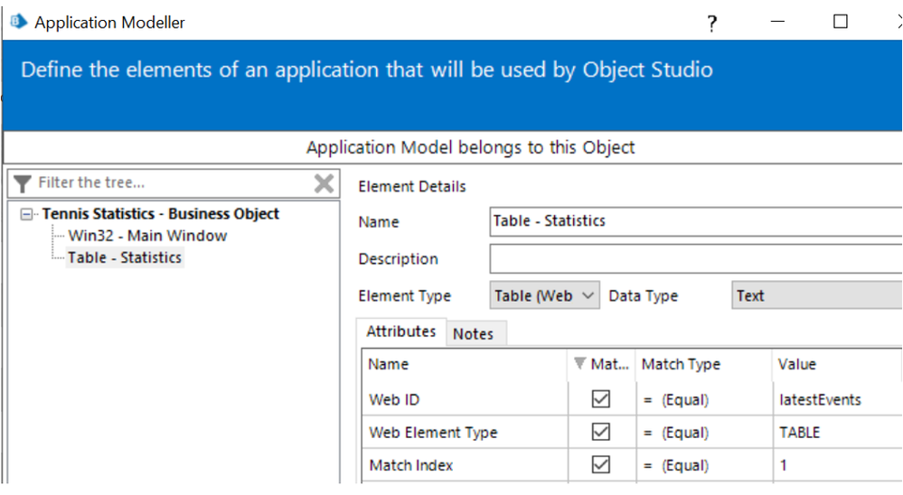

Once, you select it you can try and fine tune the attributes like I have done below:

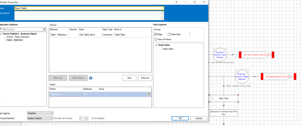

You can create the below action to check if you are getting the desired results or not:

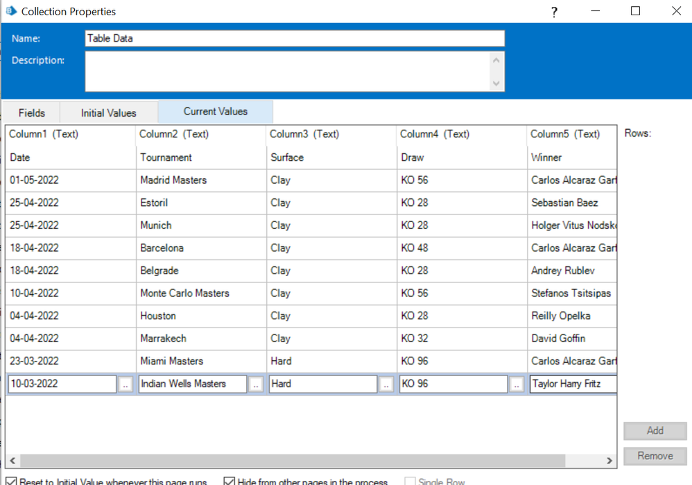

To read the table properly, you just need to use a reader stage having the action set as 'Get Table Items' and have the table element mapped to a collection stage as shown below:

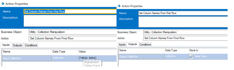

Here, I have used an action stage at the end for the action 'Set Column Names From First Row' from 'Utility - Collection Manipulation' since the table consists of headers as well as a part of a separate row as shown in the above screenshot which we can set as header row using this action.
Please find the attached bprelease file for more details.
