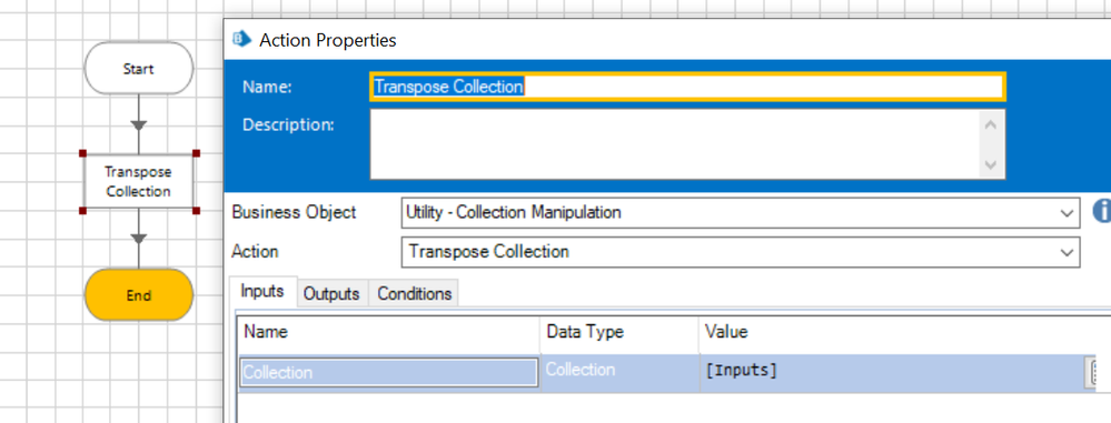

But I can suggest a very easy approach to get the desired results from the
API Calls collection that you are getting. After getting this collection, you can use the '
Transpose Collection' action from '
Utility - Collection Manipulation' VBO. Below, you can see I have an input collection with the same structure as you have provided:
Input Collection:
Now, if I use
Transpose Collection action with the following parameters:
Below is the
output collection that I get from it:
As you can see here, I get an output collection with two columns called '
Name' and '
Value' consisting of two rows now.
