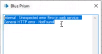

We've exposed a Web Service with HTTPS certificate and it is imported successfully in blue prism with username and password.
But while we run that action from the blue prism process/object it throws below error.
"Internal:Unexpected error Error in web service - General HTTP error - Not found"
We're not able to understand what this error means and what can be the root cause.
Any idea about this?

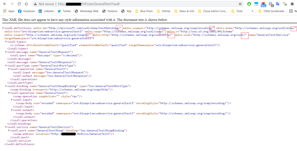

08-10-21 01:35 PM
Hi @Tejaskumar_Darji,
I don't think we can access that URL. What @AmiBarrett is suggesting is that you look at the actual WSDL file and verify that the values of all xmlns entries end with a "/" if they are a URL. Here's an example. Notice the items marked in red:
Have you tried accessing this service using a tool like SoapUI? That's usually what I go to in order to test and issues I run into with Soap web services.
