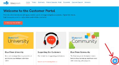

Hi @l.rollman ,
When they refer to web chat, they mean the chatbot on the main page:

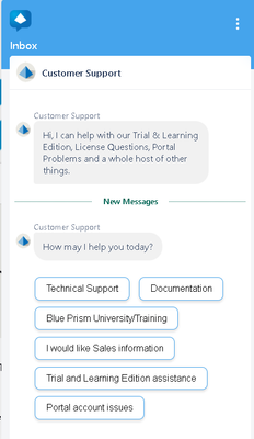

Once you click it, you will get a little popup menu:

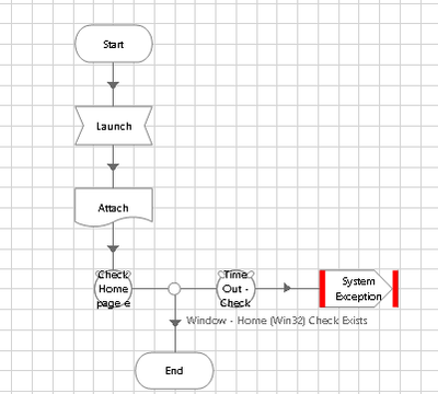

So basically, what you will need to do is to create a "Launch" action, and an "Attach" action in your object.
The attach action should not be published, and used as a page reference after launch.
Something like this:

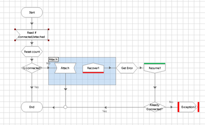

The attach action itself, should look something like this:
