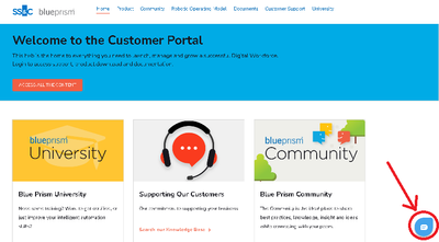

Hi @l.rollman ,
When they refer to web chat, they mean the chatbot on the main page:
Once you click it, you will get a little popup menu:

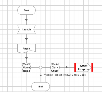

As to the issue you are describing @l.rollman I can help with that.
What is happening is that the applications you are launching, require attaching after launch... as the pipe connection established initially during launch is being forcibly terminated by the application.
This is the case with the Win11 apps you mentioned.
So basically, what you will need to do is to create a "Launch" action, and an "Attach" action in your object.
The attach action should not be published, and used as a page reference after launch.
Something like this:

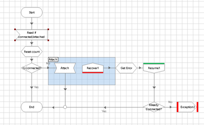

The attach action itself, should look something like this:
hope this helps

As for the Webchat, the Icon is not appearing when I log in to the main page of the customer portal. This is for both Microsoft Edge and Firefox. I have not yet tried any other browsers.
