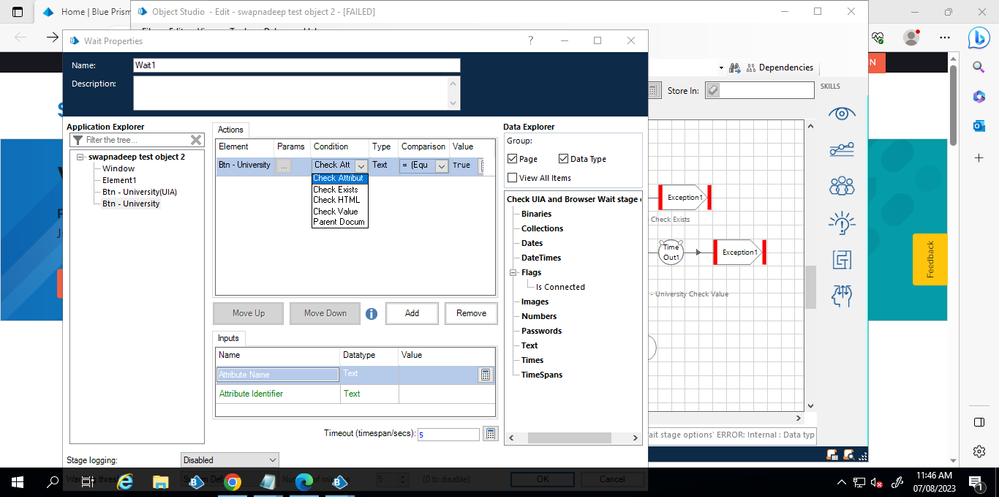

Hi Designers,
We are currently migrating to BP v7.1.1 from v6.6 and the inclusion of Parent document loaded in Wait stages when an element is identified using Browser mode pops up the lack of clarity we always had on when to use which wait action.
Could we get a clear explanation on when should we use each of them below -
  1. Check Exists
  2. Parent Document Loaded (is it a redundancy over Check Exists , if not when to use it)
  3. Check Attribute
  4. Check HTML
  5. Check Value

I can relate to what you tried to explain and that's the reason I used Parent Doc loaded while automating IE. My question is then why can't we always just use parent document loaded at the start of an action ? Doesn't it nullify the usage of Check Exists ? Is it better in terms of CPU efficiency ?

Got it now. So it depends on the situation/site I am automating. Like for the case where a scroll down is necessary before interacting with an element etc.
If only the element visibility is a requirement then check exists should be the go to approach to save time.
Could you also give an understanding of the other wait actions like check HTML, check Value,check Attribute OR refer the blueprism document you were mentioning that explains the same ?
