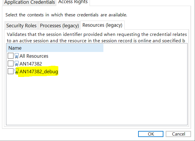

Hi aanchal mathur - In simple terms -(Development Environment Scenario) When you are inside the Process Studio (Debug Mode) - there is a separate instance which is automatically created as an instance of the runtime resource, the moment you play or run the process inside the process - which is named as MachineName_Debug and when you are running that process from Control room by dragging the process to the available resource - Runtime Resource is responsible to run it.
See below :- Debug resource in highlighted which is responsible for running the process inside the studio.

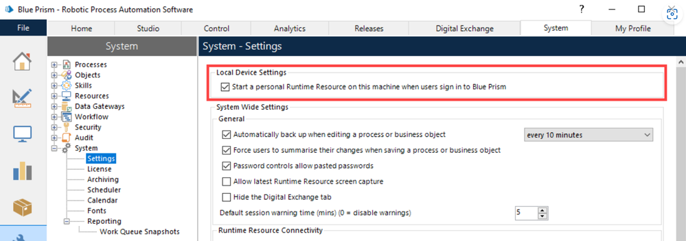

In Development Environment: This setting is triggered by a user/developer who logs in to Blue prism software: System > Setting > Local Device Setting:
