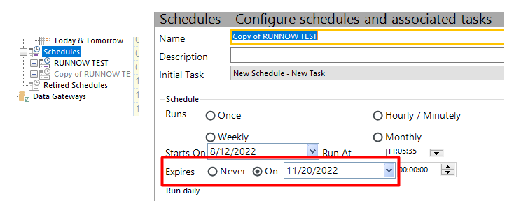

What is the difference between normal schedules and greyed-out schedules?
See below for reference. Also, this happens in the retired schedule list as well.

That happens when you have a schedule with an expiration day. In my case, my schedule was set to expire on 11/20, so today shows as grey out.

Thank you Luis for clarification. That helps.
