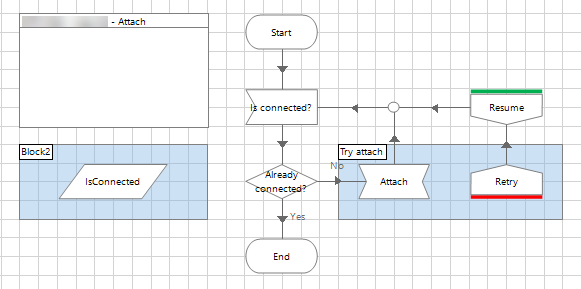

What I was thinking about doing, was having an attach action (as you mentioned) which first checks and then attaches if necessary, like this:
The only downside of this is that you have to remember to call in the beginning of every action. Which is why I wondered if you could get it to run automatically, by putting it in the initialize action.

If you are having this as initialize action later point of time in code achieving attach would be complex in other places if required.

I think it'd be nice if Blue Prism implemented a way to configure attach to be automatically run in an object. That does seem like a cool idea, but as with most flow-related activities in Blue Prism, it tends to be designed such that we need to specifically an purposefully do something. It causes Blue Prism processes and objects to be filled with tons of stages, but the standard approach works pretty well.
I think it's important for Blue Prism developers to be used to dropping in an Attach subpage reference at the beginning of every action, and a code review checklist can help make sure it gets done before deployment.
