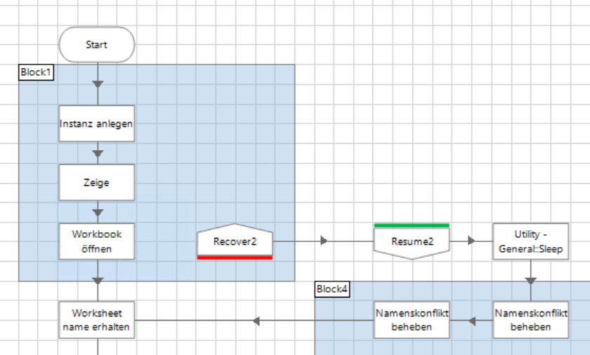

I am trying to open an excel workbook in order to read from it later on. To do so, I use the excel vbo and do the following steps:
1. Create Instance (Enable Events = False)
2. Show
3. Open workbook --> Output should be saved in variable "workbook"
Since this is failing because of some "Nameconflict" message, I inserted a recovery path in order to resolve the conflict. All of this is working fine, the workbook is open at the end of these steps BUT the variable "workbook" stays empty. The end of the recovery stage is linked with the next action, which should get the worksheet. Might this be the problem? What could I change?
What am I doing wrong, how can I receive a value for "workbook"?

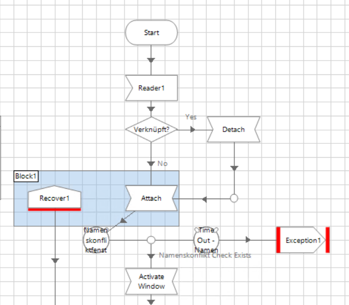

We have the convention to write in german, but I hope it still helps. All actions are Excel VBO actions, except the "Excel_Namenskonflikt". I attached a screenshot of this in the object studio, too.

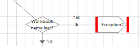

I check with a decision if the name is empty for test purposes.
handle receives its value from "instanz anlegen" which is Create Instance. "Zeige" is show. "Workbook öffnen" is open workbook, which uses handle and a path.
