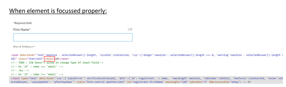

For the website that you've mentioned, if we inspect any given element carefully, let's say, 'First Name' field in our case we can see the below HTML structure changes when I apply focus on it and when I don't do the same.
As you can see from above, there is a span element just above the input element for 'First Name' field which has a style attribute that gets changed when you apply focus or not. This value is empty when placed under focus while on the other hand it has the value as 'display: none;' when it is not placed under the focus. This is our first step which states that we need to identify the proper attribute which gets changed based on this event trigger.

According to the above XPath expression, we are first trying to identify an input tag with ID as 'registrant.firstName' and then we are trying to get the span tag which is just before this input tag. This ID value you can see in the HTML definition of the input tag as shown below:

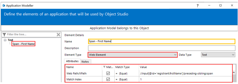

Now, in the Blue Prism Studio we can create an object and in the Application Modeler can setup a new element with the following attributes:

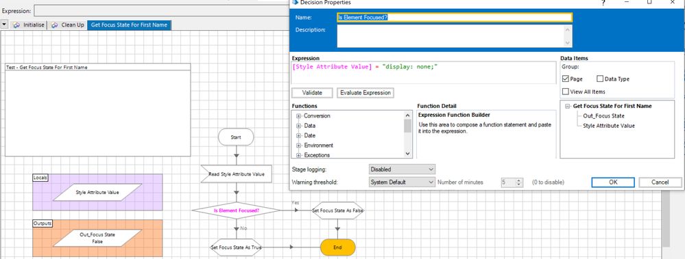

Now, you can create a logic in your action which can check if the value of the data item that we receive from the above Read stage is empty or if it has the value as 'display: none;' and based on this you can set a flag data item, let's say named as 'Out_Focus State' as either True or False as shown below:

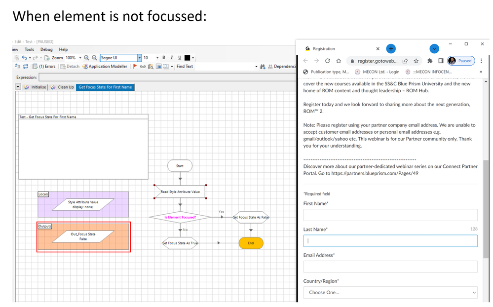

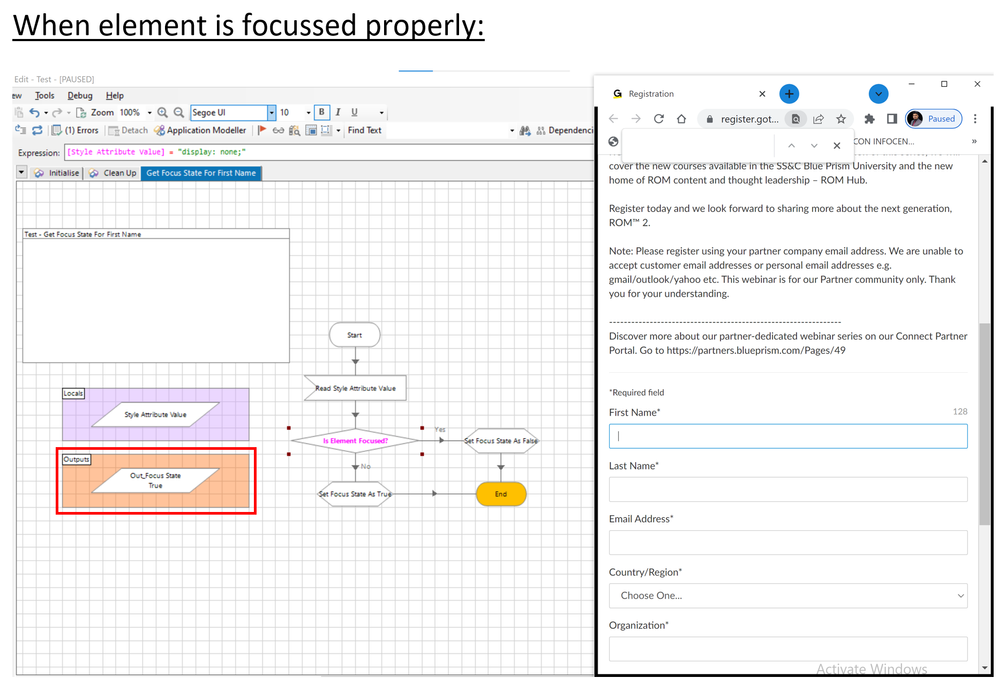

Test Results:
Test Results:
