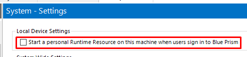

Hi Walter, the same thing happens to me (v6.5). I can only seem to get it working on the default port 8181. My understanding is this is old functionality and is basically an external version of the internal personal Runtime Resource option:
It is only controllable from within control room and it appears to only work on the default port 8181.
