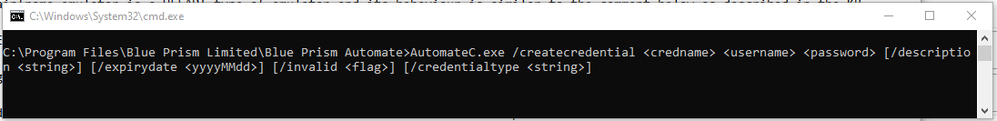

Hi Sanjib,
1)
Open the command prompt and navigate to the blue prism root folder
(You may need to open it as an Administrator)
2)
AutomateC.exe /createcredential <credname> <username> <password> [/description <string>] [/expirydate <yyyyMMdd>] [/invalid <flag>] [/credentialtype <string>]
3)
You can find documentation in the Blue Prism knowledge base site.
or
AutomateC.exe options
AutomateC.exe is a command-line tool used to script activities that are possible in the Blue Prism Interactive Client. To launch the /help, open a command prompt, and run these two commands:
cd /d "C:\Program Files\Blue Prism Limited\Blue Prism Automate"
AutomateC.exe /help

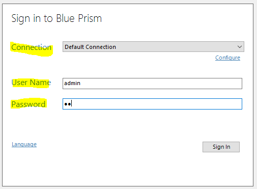

Hi Sanjib,
The user name and password are the one you use to access to the Blue Prism Login screen for that particular database connection.
