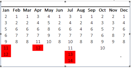

37140.png3rd case - again every 5 minutes within below days. USA Calendar Every month bot has two periods of work (5 days , then break , and next  4-6 days).
January- 11, 12, 13, 16, 17, 20, 23, 24, 25
February- 10, 13, 14, 15, 16, 21, 22, 23, 24, 27, 28
March- 10, 13, 14, 15, 16, 21, 22, 23, 24, 27, 28
April- 12, 13, 14, 17, 18, 20, 21, 24, 25, 26
May- 10, 11, 12, 15, 16, 22, 23, 24, 25, 26
June- 12, 13, 14, 15, 16, 21, 22, 23, 26, 27
July- 12, 13, 14, 17, 18, 20, 21, 24, 25, 26
August- 10, 11, 14, 15, 16, 22, 23, 24, 25, 28
September- 12, 13, 14, 15, 18, 20, 21, 22, 25, 26
October- 12, 13, 16, 17, 23, 24, 25, 26
November-13, 14, 15, 16, 22, 23, 24, 27, 28
December- 12, 13, 14, 15, 18, 20, 21, 22, 25, 26, 27

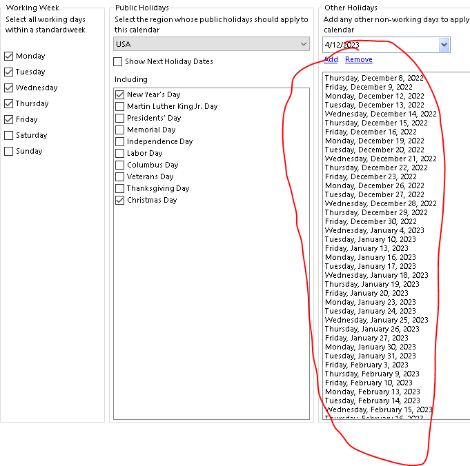

The only option which I am aware is to create dedicated calendar for this bot (with holiday of all not green marked days) and then schedule it every few 5 minutes/1 hours. Every year in November I am receiving expected calendars for next year. And then I am going to calendar, and adding a lot of holidays, day by date. Example of my calendar:
37141.pngThis is very time consuming and manual work.

  • It looks like you have far less working days that holidays, which I’m assuming in the problematic thing for you.  In your case, I think the solution to your request is to “only run automations on these dates”, then have the ability to set the “working dates” rather than the holidays as is today.
  • Tip: Using the Blue Prism 7.2 API (or later), you can programmatically update your Calendars, so you may find is simpler to update the Calendars programmatically each November, based on your dates in a spreadsheet and an RPA process, rather than updating the calendar manually.
