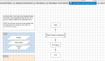

Request to have a option to come out of Business Object along with warning threshold, so that when BP is struct in between due to popup or other reasons, it should automatically come out of the VBO and we can recover that in process.
For Example: If we are working on excel and when we perform Run Macro and if there is any popup BP will be struct until someone manually open the VM and close the process.
So if we have automated process to come out of the VBO after the warning threshold, then it will be helpful as we can spy the window and close the popup by using navigate stage.

JasonCech
If you're in a Code Stage, there should be a method of coding in a timeout. Something along the C# Task library.
I made a Run Macro Timeout based on original Run Macro implements.
I think this Run Macro Timeout implements has to be added to Excel VBO officially.
- Original Run Macro implements
GetInstance(Handle).Run(Macro_Name)​
- Run Macro Timeout implements
ExecWithTimeout(Timeout, "Run Macro",
Sub() GetInstance(Handle).Run(Macro_Name))​
Also this enhancement request is already registered as US-8320.

Regarding the enhancement request "US-8320" discussed in this thread, has it already been reflected in the Excel VBO?
I checked the release notes on Digital Exchange but could not find any mention of it.
I would appreciate it if you could let me know the status.
Thank you,
Yusuke
Ninoseki
It looks like it is included in the latest VBO.
Sorry for posting about this without checking first.
Yusuke
