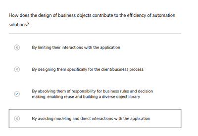

ā23-02-25 05:42 PM - edited ā23-02-25 05:46 PM
I believe that one of the early questions is incorrect. I'll put my description of it and the image below in a spoiler tag.
I think an easy fix to this would be to adjust the question/answers.
Instead, I think it should be like this, to avoid unclear pronoun reference:
What aspect of object design contributes to the efficiency of automation solutions?
1 - Limiting the object's interactions with the application
2 - Designing the object specifically for the client/business process
(correct) 3 - Absolving the object of the responsibility for business rules and decision making, enabling reuse and building a diverse object library
4 - Avoiding modeling in the object and direct interactions with the application
I recognize that this could simply be my fault for misreading a question, but I do think unclear pronounce reference is more likely the cause here.

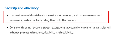

ā23-02-25 05:59 PM
In the section about Best Practices for Building a Process, it encourages people to put sensitive information into environment variables. This is incorrect. There is a password datatype for environment variables, but that does not make it a secure place to store sensitive information. Of course you can do it, but it frankly makes no sense to given that Credential Manager exists.
"Use environmental variables for sensitive information, such as usernames and passwords, instead of hardcoding them into the process."
I sure hope no one is actually doing this. You cannot restrict access to specific environment variables in any way. All processes and objects can access any environment variable.
What this should say instead is this:
"Use Blue Prism Credential Manager for sensitive information, such as usernames and passwords, instead of hardcoding them into the process."
ā24-02-25 09:01 AM
@david.l.morris thanks for the feedback, I have the team checking on this now and will let you know an updated when I have one.
ā24-02-25 09:10 AM
Hi Dave,
Thank you for taking the time to provide this valuable feedback. It's a great point, and we completely agree that Blue Prism Credential Manager is the recommended approach for handling sensitive information such as usernames and passwords. We appreciate you bringing this to our attention, and we will update the course content accordingly to reflect best practices and ensure clarity for learners.
We truly value contributions like yours in helping us refine and enhance the learning experience. Thank you.
