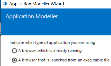

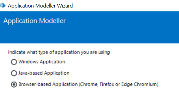

Check if the browser extension for Chrome/Edge or Firefox wherever you are trying to implement your automation has been installed or not once. If it has been installed, check you application modeler setting where initially you must select the below configuration option:
Then you should select the run from executable option:

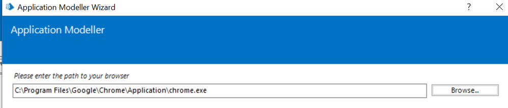

And check if the correct path to your browser has been provided or not:
Then you can provide the URL of the application if you want and then just choose the default settings till the end and see if you are able to see Browser mode option while trying to switch over spying modes. This usually happens if either extension has not been installed properly or if any of the prior configuration settings were not applied which I showed you.
