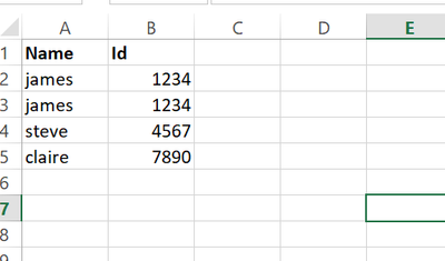

I am building a process that needs me to check for dupicates before progressing to the next stage. I have checked through the MS Excel VBO and i cant find any action that can perform the action i want to perform. How can i remove the duplicates on the column Id?

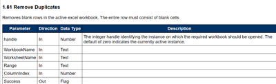

Thank you Michael for responding to me, I have the latest version of Excel vbo and it includes the action remove duplicates but from the Business object definition page it was stated that it can be used to remove blank rows which is not what i want to achieve at the moment. Please see attached below.

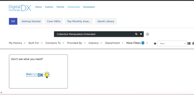

Also,I was not able to see the aforementioned vbo Collection Manipulation Extended on the Dx portal so as to use the action extract duplicate.

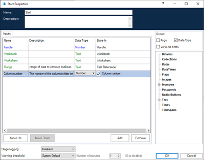

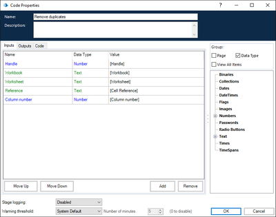

I would also appreciate having the code to remove duplicates in Excel, as I am eager to learn how to create my own actions.

Do you still need help on this ?
If yes, show us your desired output and we will create a custom code for you
3 weeks ago

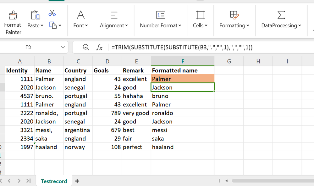

The code worked perfectly, and the formula TRIM(SUBSTITUTE(SUBSTITUTE(A1,".","",1),",","",1)) produced the expected result when applied manually in Excel as shown below. However, I’m trying to create an action that performs this operation across all cells in my Name column. I attempted using the "Set Cell Value" action, but it applied the same value to every cell in the column. so I believe I may be missing something or doing something incorrectly. I am also thinking of creating a loop but it doesnt sound robust because what if i have 500 row datas. please what do i do.
3 weeks ago
Ah sorry i maybe havent given full instructions there, the formula should be inserted into one cell initially and then that cell dragged down to autofill the rest. The formula references are dynamic so it will auto update as the formula is dragged down. I believe in the latest excel vbo there is an aciton to drag values downward so for the example you have given insert the cell value to F1 and then drag down to F 10

I have successfully resolved my issues just as you have directed. The action in the MS Excel VBO is Autofill, and I’m truly happy and grateful!
