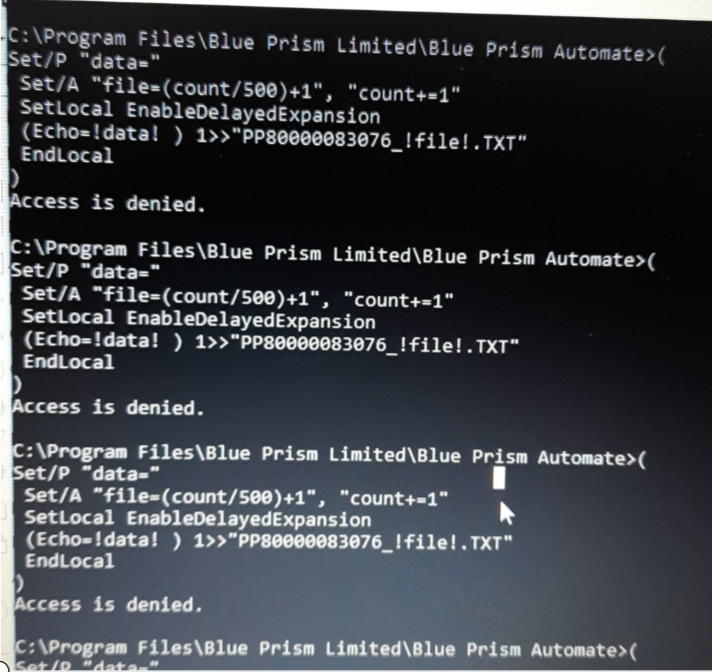

while running this batch file from cmd i am not getting any error and getting the desired output. But when i run the same from BP start Process action it gives me "access is denied" error. please help me to find the issue. I have attached error image for the reference.

Hi Rajkumari,
I think it is trying to create files in Blue Prism directory. Try changing the directory to file path where you want to save the file in batch file or for file path of batch file use cd %~dp0
Hopefully, this will resolve the issue.
