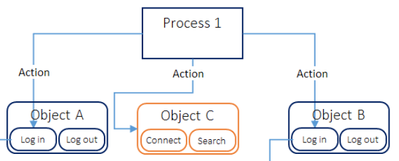

Now, by definition you already must be aware that when a Blue Prism process runs, any business object that is called via the action stage will always occupy the memory at the time of the initialization and will basically hold that memory for the entire duration of the process and creates an unique instance of the application modeler and the business object. - It means if I call three business objects named Object A, Object B and Object C within a process and they are non-shareable, then a separate instance of the object and associated application occurs. In the example below, there would be three separate instances of Object A, Object B and Object C and the associated application.
When you basically use the action stage in a process to call one of the actions of the business objects that refers to a shareable business object, then it is the shareable business object which would hold the memory for the entire duration of the process and would be part of a single session. It means that later even if you call another action of let say another business object that refers again to the same shareable business object within that process, it would not create a separate session but would be treated as part of the same session of the shareable business object.
Here, Object C is a sharable business object and only a single initialization of the associated application occurs. So, what does it mean? - In simple terms I would say if you wanted to access the same application as part of different sessions you basically cannot do that if your associated business object is referring a shareable business object.

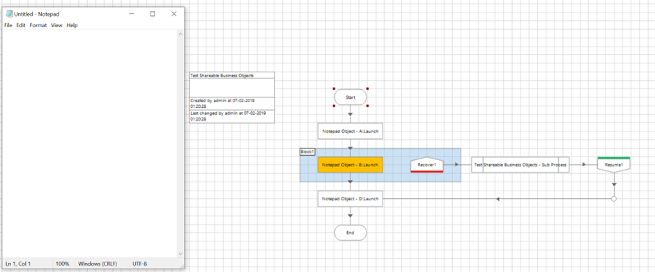

Now, I have prepared a workflow as below to demonstrate my explanation provided earlier:

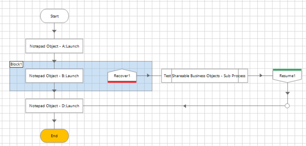

Main Process:
Sub Process:
What I am doing here is pretty straight forward, I will first call launch action of Notepad A, then call launch action of Notepad B, if any error occurs while calling launch action of Notepad B, I will call a sub-process where I am calling the launch action of Notepad B and then at the end I call the launch action of the independent business object Notepad D.
When I execute my workflow, you will first see that the first action will launch the notepad application. Here the Notepad - A business object is referring to a shareable business object Notepad C so a single instance will be created for Notepad C during the entire execution of this process.

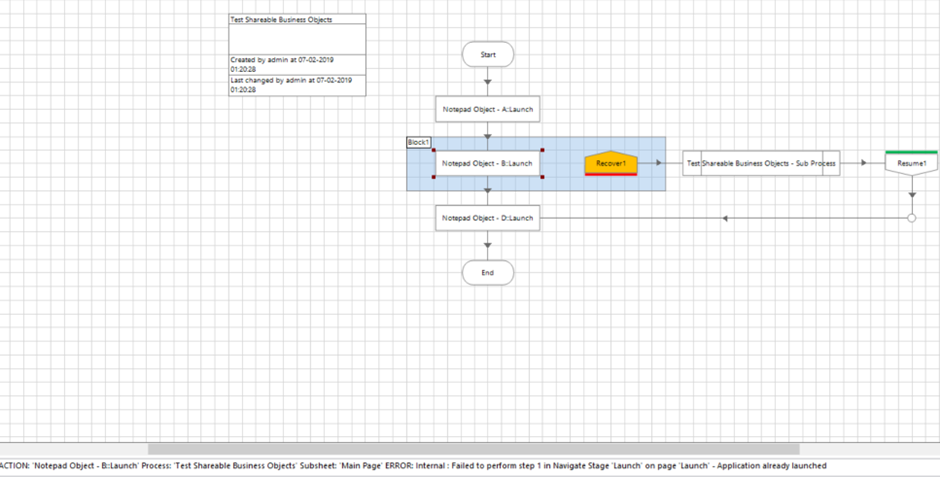

Now, when I will execute the next launch action for Notepad - B business object, I will get an error stating that the application has already been launched so it cannot re-launch it. This will happen since Notepad - B business object is also referring to the shareable business object and we know that in a single process only one instance of the business object can be used for a shareable business object.

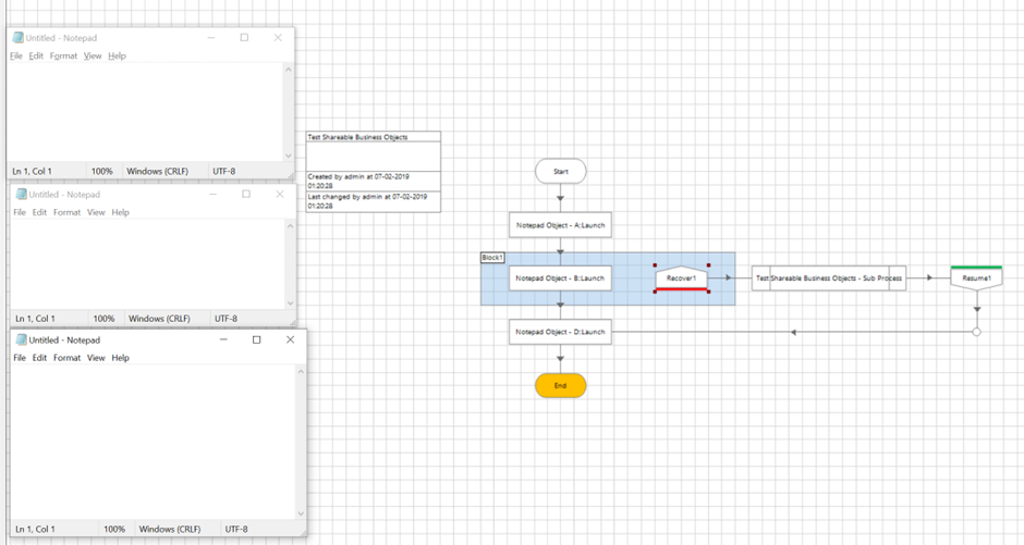

Now, when I execute the sub-process, there the flow would work and launch a new notepad application for Notepad - B business object as even though it is referring to a shareable business object it was used in a separate sub-process which by definition should allow the action to work.
Finally, when the workflow will execute the launch action of the Notepad - D business object it should also open the Notepad application as it is not referring to any shareable business object and thus it will create it's own application instance.
