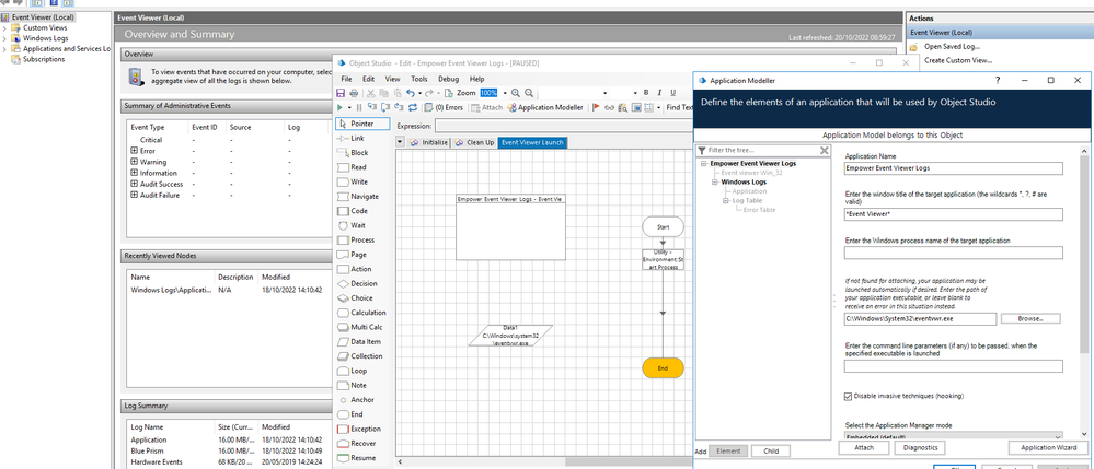

I want to launch "Event Viewer" through window application modeler. But I am getting an error "Internal exception: Failed to launch" .
I tried not only with launching option, I also tried attach option in application wizard, still it is failed to launch or attach the application.
Can anyone suggest me a way for it??

I am already having the BP Interactive client permissions. I can go open the same application manually.
But when it comes to bot I can't attach the application.
After doing it in Utility Environment - Start process I am trying to attach the application and i got this issue again

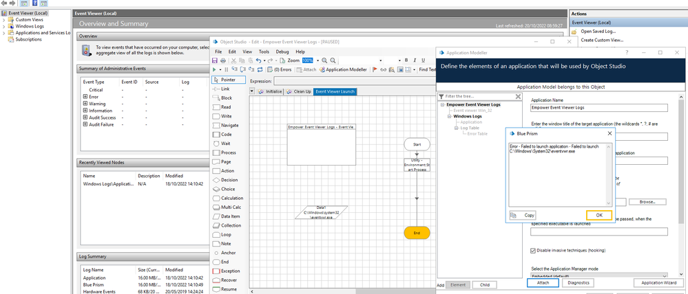

I had done the same thing as run as administrator and trying to attach after running with Utility environment - Start process and trying to attach the application.
I am getting the above error only "Error - Failed to launch application - Failed to launch C:\Windows\System32\eventvwr.exe".
