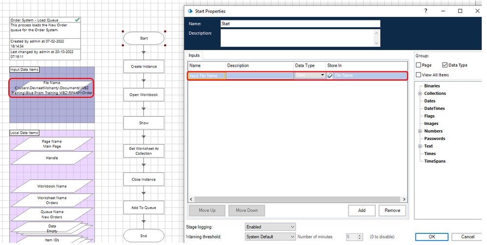

If you want to pass any information into the process, you can do so once you have set input parameters in the 'Start' stage of your Main page in the workflow. Once, the input parameters are set which are also referred to as Startup parameters​ for a given process, you can use the following command format to pass on any input values:
AutomateC.exe /run "<Process_Name>" /startp "<inputs><input name='{Parameter1_Name}' type='{Parameter1_Type}' value='{Parameter1_Value)'/><input name='{Parameter2_Name}' type='{Parameter2_Type}' value='{Parameter2_Value)'/>...<input name='{ParameterN_Name}' type='{ParameterN_Type}' value='{ParameterN_Value}'/></inputs>" /user "{user_name}" "{password}"
Test Workflow:
Here I have a process called, 'Order System - Load Queue' and as you can see, I have defined a start-up parameter here called as ' Input File Name' mapped to a data item called as 'File Name':
Now, once the process is published, I make the following call in my command line prompt:
AutomateC.exe /run "Order System - Load Queue" /startp "<inputs><input name='File Name' type='text' value='{Input_File_Path}'/></inputs>" /user {Username} {Password}

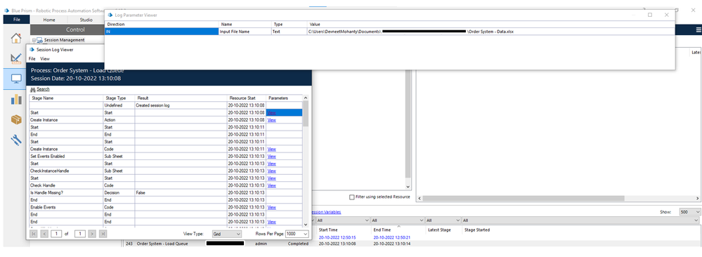

And you can see the session logs where it ran with the start-up parameters in place as well below:
