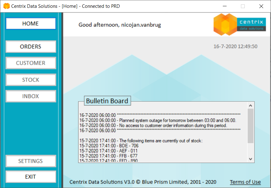

I'm using the CentrixDataSolutions application that is provided with the course.
Until this point no problems. I managed to Login and display the Home Screen.
The next step would be press on ORDERS button and then select Option 1 for New Orders.

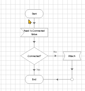

All of your objects should have a check to see if you are attached to the application you are trying to communicate with. Each object should have an Attach page that you call before try moving forward.
The attach page should look like this:
When you get to your Input Order page, the first step after the Start should be the Attach. If the application is not attached, it will get attached.
Let us know if you are able to get this working.

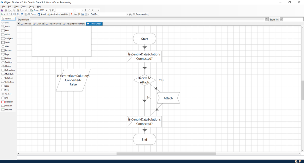

Hi Jack. Thanks for the explanation.
Here my business objects as screen print.
I'm calling this business object from my main business object:

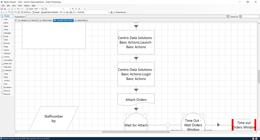

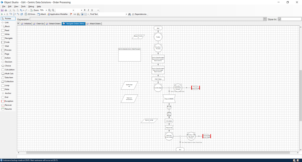

Hi Jack, here my Navigate Orders Menu.
As you can see I now use a Page to call my Attach Orders Page. Before this I used a Action to do this. The result form Attach Orders was the same: the application was connected. So why did I get a not connected while pressing the ORDERS button and worked it without any problems using a Page Reference in stead of a Action?
