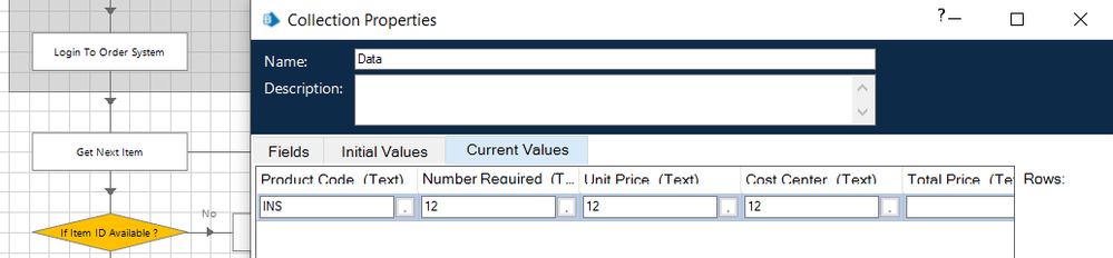

Here you can see that while using 'Get Next Item', I am getting the following data collection:

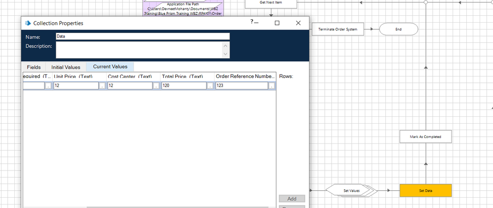

So in my process, I am entering some details in order to receive the total price and order reference number. I am setting up the values that I got for the fields again back to the same collection which was returned to me for the current item ID:
So now if I want I can again update this data back to my work queue using the 'Set Data' action:
Note that this data collection only has one row and it corresponds to the data that is referring to the current Item ID for which I am setting up the updated values.
