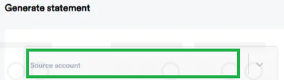

Hey everyone, I'm trying to retrieve items from a dropdown list or input the first few characters into the dropdown box to select an item. Is there any method that can help with this? The dropdown box is editable.

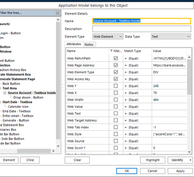

Hi @girabor ,
Can you pls share the screenshot of spied element in app modeller and which spying mode your are using? Also can you provide me the options when you use the element in navigate stage?

Okay thanks, This is what I spied and this is the what the dropdown entails and I am using browser mode to spy.

Hi @girabor
As you can see your web element type is a div.
For a drop down list it should be for example a select or a list web element type.
Some application even if we are dealing with a drop down list, the developper create them as a div so we cannot use the navigate action and put "select item" or the read action stage to get the items of that list.
What i can suggest you, try to inspect your application and try to find in the DOM (html tree) near of your drop down list (maybe parent element or child element) if you have a select or list web element type and then maybe we can do something 😉
If you want and you are confortable with this, try to inspect and then take a screen shot and we will help you.
