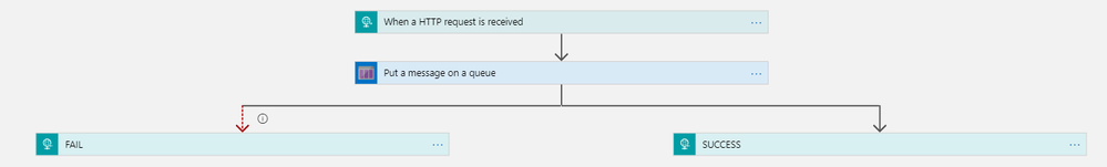

Once the logic app resource is created, proceed to design a flow that is triggered when an HTTP request is received. The process will contain an "add to queue" action and for completeness, a response should be returned at the end of the process. The resulting process could look something like this:

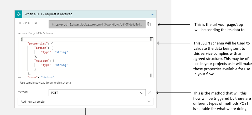

The HTTP trigger I've built looks something like this:

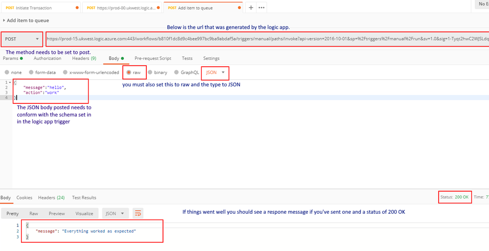

Once complete you've completed your flow, use Postman to test it. Below is an example of how I've tested my implementation:
After executing the above request, we can also check the storage queue in the Azure portal.

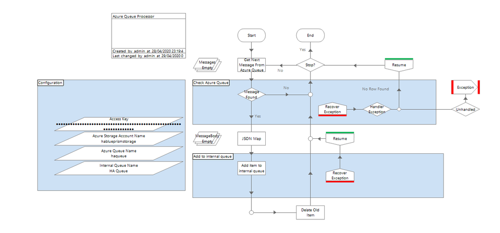

Below, is a rustic implementation of a process that polls the Azure queue and places a new item into the internal work queue.
The first sage uses the VBO downloaded from the Digital Exchange to access the Azure queue. Interacting with the queue will require the following Azure storage parameters:
  • Storage Account Name
  • Queue Name
  • Access Key
After identifying that an item exists, we map the MessageBody to a collection using the Utility - JSON VBO. This returns a collection that is used as the payload for the item that is added to the internal Blue Prism work queue. The process continues to poll the Azure queue for new messages until a stop request has been received from the Control Room.

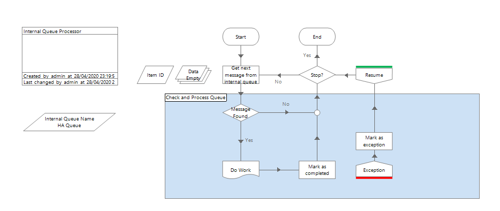

The image below depicts a process of how the other Blue Prism digital workers are simultaneously polling the internal work queue for work.
In the process, the Do Work page reference is where your Blue Prism digital worker would interface with the line of business systems to carry out its work.

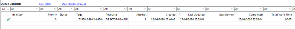

After implementing all of the above steps, and executing the above processes, we can verify that everything has behaved as expected by visiting the internal queue using control room. The image below shows a work item that has been completed successfully:
