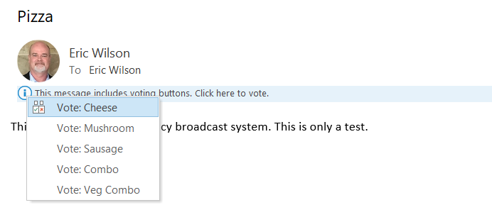

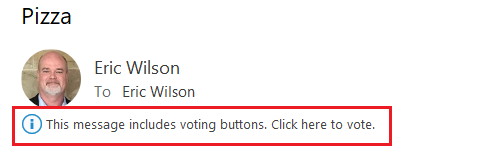

As for voting options in the Outlook VBO, they didn't exist until you asked for them. :beaming_face_with_smiling_eyes: We've just added a quick update to the Send Email action to support this feature. There is now an optional input field called Voting Options. All you need to do is pass in a semicolon-delimited string of values. Those will be rendered as the choices in the vote. In my case, Microsoft 365 displays it as depicted below:
5817.png-----------------------------------------
5818.png-------------------------------------------------------------------
This will be version 6.10.3 of the VBO and we should have it posted to the DX within the hour.
