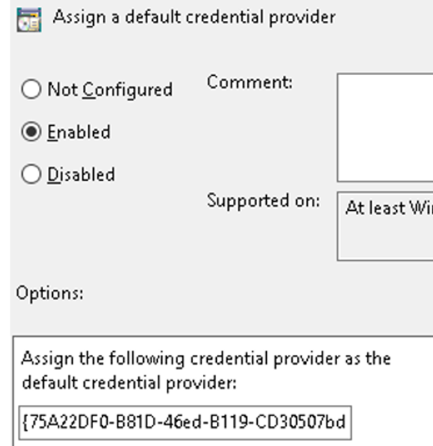

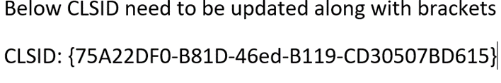

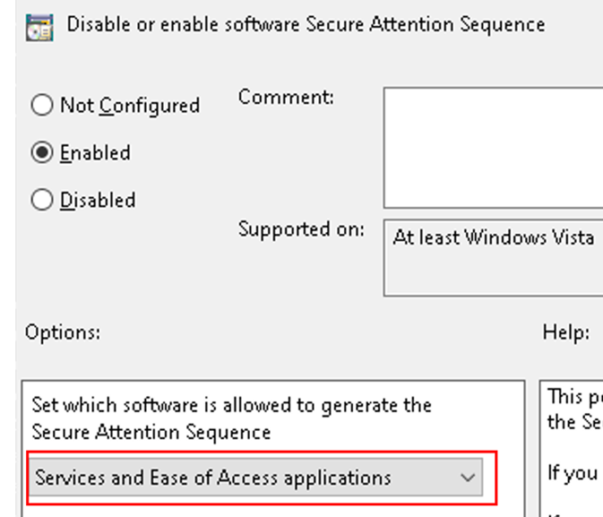

Cross check whether below group policies are enabled in VM server and login agent services are up and running.
Note: Also check blueprism listener is up and running
Group policies:
