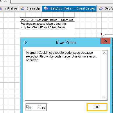

I am however having issues with the coding of the MSAL VBO.
When testing the object in Object studio [Get Auth Token - Client Secret], it returns an access token without issue.
As soon as I integrate the VBO Action into any Blue Prism process it results in an internal error:
  • Internal : Could not execute code stage because exception thrown by code stage: One or more errors occurred.
Do you have any insight into what might be the cause?
Edit: Resolved. Access Token had to be changed from the auto chosen Password to Text.

I am also having issues with the MSAL.NET VBO - while trying to use it to retrieve a token to use with the new configuration action in the Email/POP3 vbo​.
I have TenantID, ClientID, Client Secret and Scope, I have added the dll to the Automate folder on the Management Server but the worker does not seem to be able to access that? I don't seem to have permissions to add the dll directly to the worker's automate folder. Am I misunderstanding something here and adding the dll to the wrong place or in the wrong way? I have logged out and back in again to Blue Prism and restarted the worker.
Running a process with the MSAL Get Token using Client Secret gets a compiler error on the worker ( can't find dll), on the MS it compiles okay but still gets a similar error response as posted by Arni - one or more errors occurred.
We are using v6.10.1
I realise this may be some basic error on my part installing the MSAL vbo and dll, but any help or suggestion would be appreciated.

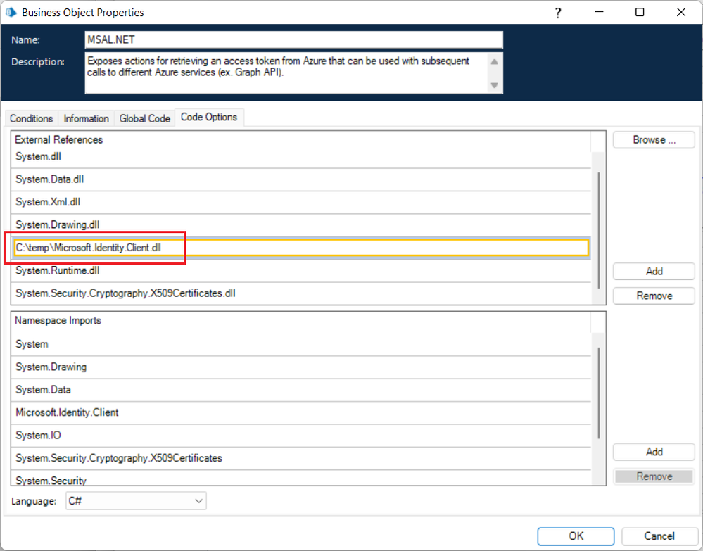

Hello @Kirk Russell,
There are two ways to address this. Assuming you do not have permissions to add files to the ​Blue Prism folder (i.e. C:\Program Files\Blue Prism Limited\Blue Prism Automate) you can either:
  1. Raise a support ticket with your IT folks and request that they add the DLL to that folder.
    OR
  2. Place the DLL in a different folder (one you have access to) and then change the DLL reference in the VBO.
If you opt for #2, you can change the DLL reference by opening the MSAL.NET VBO and then double-clicking on the Note stage on the Initialise tab. From there, you want to go to the Code Options tab and edit the definition of Microsoft.Identity.Client.dll within the External References list. You'll want to add the fully qualified path to the DLL. Here's an example with the DLL placed in the Temp folder (not ideal):
You will need to restart your Blue Prism client after making this change.
