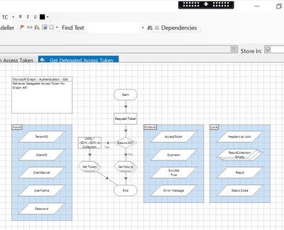

I have implemented a solution that using Microsoft Graph API to Integrate MS Teams.
The solution worked fine using delegated access token action for authentication with dev bot id.
But when moved to prod with a new bot id and new VM , the authentication is not working.
Please note we are using same client id , client secret & tenant id for both dev & prod BOT ID.
Getting below error.
{"error":"invalid_grant","error_description":"AADSTS50079: Due to a configuration change made by your administrator, or because you moved to a new location, you must enroll in multi-factor authentication to access '00000003-0000-0000-c000-000000000000'. Trace ID: 15114538-6ccd-497b-8521-129986ae3a00 Correlation ID: 8289e125-5004-4e82-91bc-7e619a3f1444 Timestamp: 2024-04-08 10:12:06Z","error_codes":[50079],"timestamp":"2024-04-08 10:12:06Z","trace_id":"15114538-6ccd-497b-8521-129986ae3a00","correlation_id":"8289e125-5004-4e82-91bc-7e619a3f1444","error_uri":https://login.microsoftonline.com/error?code=50079,"suberror":"basic_action","claims":"{\"access_token\":{\"capolids\":{\"essential\":true,\"values\":[\"08751b15-34db-441c-954c-38a6af8f8513\"]}}}"}
Action used : Get Delegated Access Token.
Your advice will be helpful, thanks!
