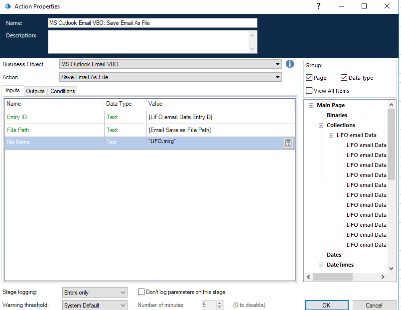

My next question is: using the Save As VBO for outlook.. You have to have an "Entry ID" (which I took from the collection) and had a file path. Below is the error I am getting. Any thoughts.
I used quotes around the file path.
I used the "Entry ID" from the collection(Text) and gave the file a name to use.
What am I missing here? Thanks

I figured out my other issue. I was putting quotes on my file path and had to add a backslash.  Rookie mistakes.

No worries. Gotta love that helpful error: "The operation failed." Hahahahaha!
