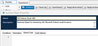

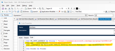

So I tried my old VBO (from BP 6.10.2) and it worked perfectly. Then I compared the codes and realized that the declaration of the app and namespace objects changed from the "Internal_Get_Items" page to a global declaration in the "Initialize" page.
The last VBO that declares the objects inside the "Internal_Get_Items" page was distributed with BP 7.2.1.
The version on DX moved it to initialize (and rises an error following the steps I've mentioned).
Legacy Outlook VBO - BP v7.2.1
No code in "global" declarations

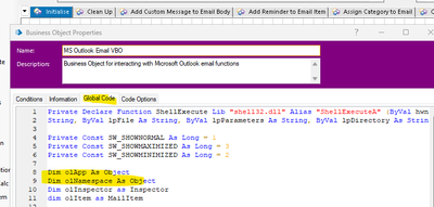

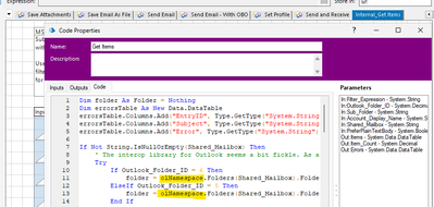

Legacy Outlook VBO from DX
Object olApp and olNamespace are declared in Global Code and initialized via code inside "Initialize" page.
Inside "Internal_Get Items" page the objects are used...
I'm sharing that because NetOffice VBO has the same idea. The objects are declared in Global Code, which could affect how they are "disposed" of after Outlook closes.
According to my tests, we have an issue with both VBOs available in DX (NetOffice and the Legacy Outlook VBO).
