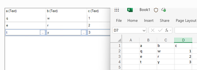

I have implemented a process where a collection hast to be written to an Excel. As a test I created an Excel with the name TestExcel.xlsx and the table “Tabelle1”.
The Excel can be found, because I can copy it or read data out of it. But writting from a collection to the Excel does not work.
There is no error message. Everything looks fine. But, the collection is not written to Excel.

I read the IDs via the Graph API. To make sure that I don’t have the same Excel anywhere else, I created a new Excel with different data in a different folder. That is, this time I read data from Sheet2 (Tabelle2) and write data to Sheet1 (Tabelle1). The IDs must be correct, otherwise the Get Worksheet as Collection would not work. But Sheet1 remains empty.
What else I noticed is that I receive the following error message
when writing collection, if the collection contains numbers, even though the collection is formatted as text:
When the collection has just text (in RowA) there is no error message.

I found out that no session ID can be passed to Write Collection. Carl Carter (from BluePrism) pointed out to me that I should not use Open Workbook. Then no session ID is passed and it works 😉
