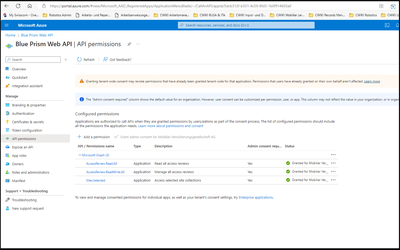

have implemented a process where a collection hast to be written to an Excel. As a test I created an Excel with the name TestExcel.xlsx and the table “Tabelle1”.
The Excel can be found, because I can copy it or read data out of it. But writting from a collection to the Excel does not work.
There is no error message. Everything looks fine. But, the collection is not written to Excel.
I use the actions Authenticate, Open Workbook, Write Collection and Close Workbook.
Could it be a permission problem? Attached you can find the BP API permissions.
Thanks for your help.

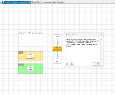

What else I noticed is that I receive the following error message
when writing collection, if the collection contains numbers, even though the collection is formatted as text:
When the collection has just text (in RowA) there is no error message.
